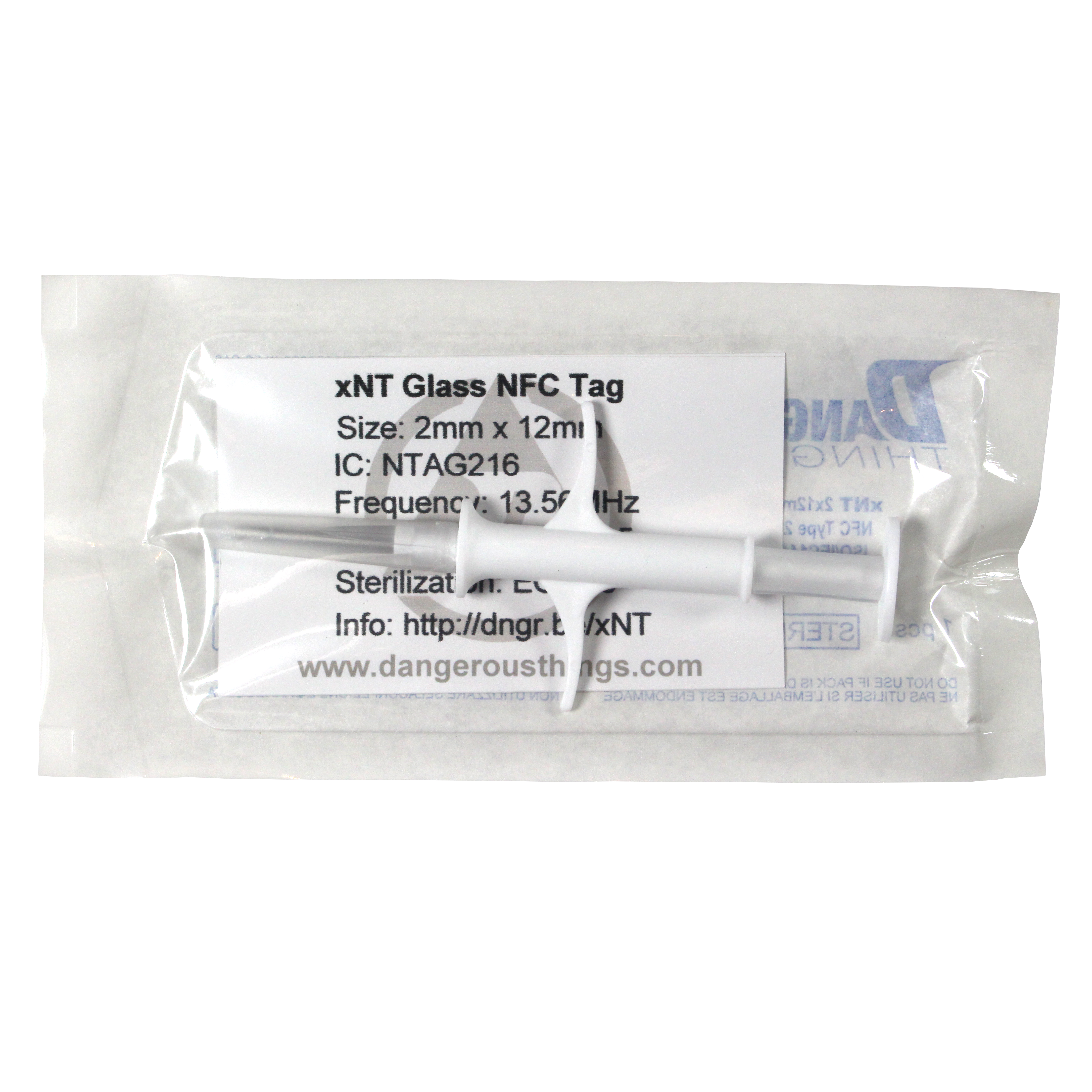

  • Pre-tested and pre-loaded into sterile injection assembly
