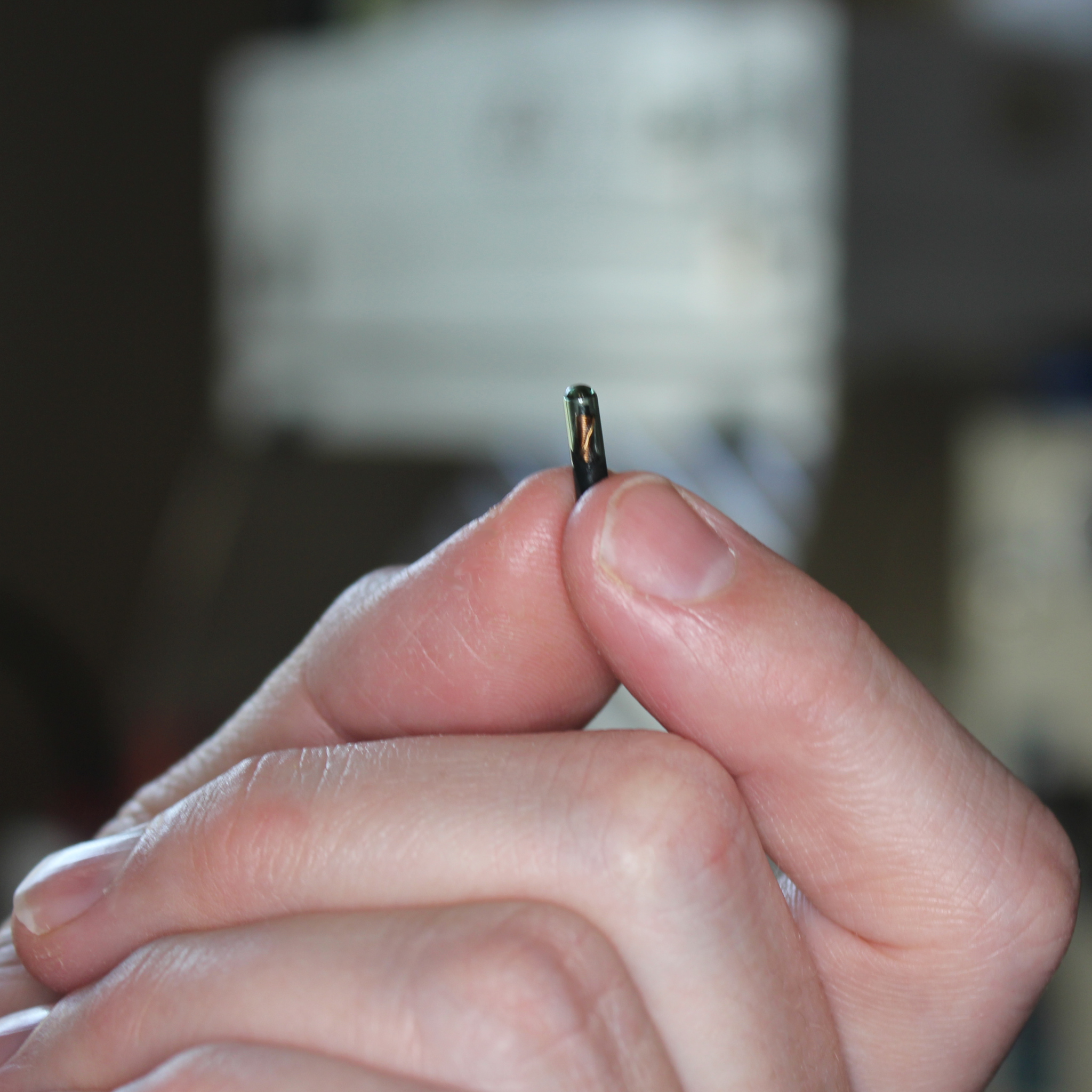

  • 3x13mm cylindrical sterile bioglass implant

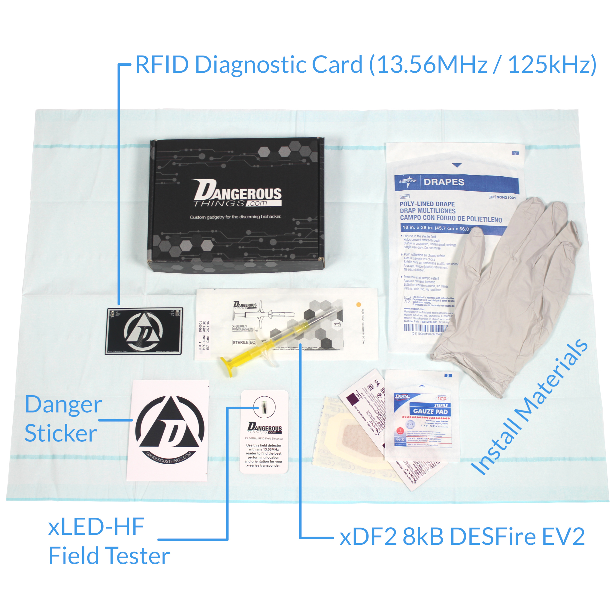

  • RFID Diagnostic Card and xLED-HF included!

The xDF2 also comes with some additional goodies, including a xLED-HF field tester, and the RFID Diagnostic Card. The RFID Diagnostic Card is a nifty little tool you can use to easily detect what frequency and duty cycle any contactless reader is operating at. What it does not do is tell you where and how to place your xDF2 on the reader to get the best performance. That is where the xLED-HF Field Tester comes in. Place the xLED-HF up to a 13.56MHz reader and begin moving over the surface of the reader while trying different rotational orientations. Once the white LED inside lights up you will know that placing your xDF2 up to that reader in the same location and orientation will yield the best performance.

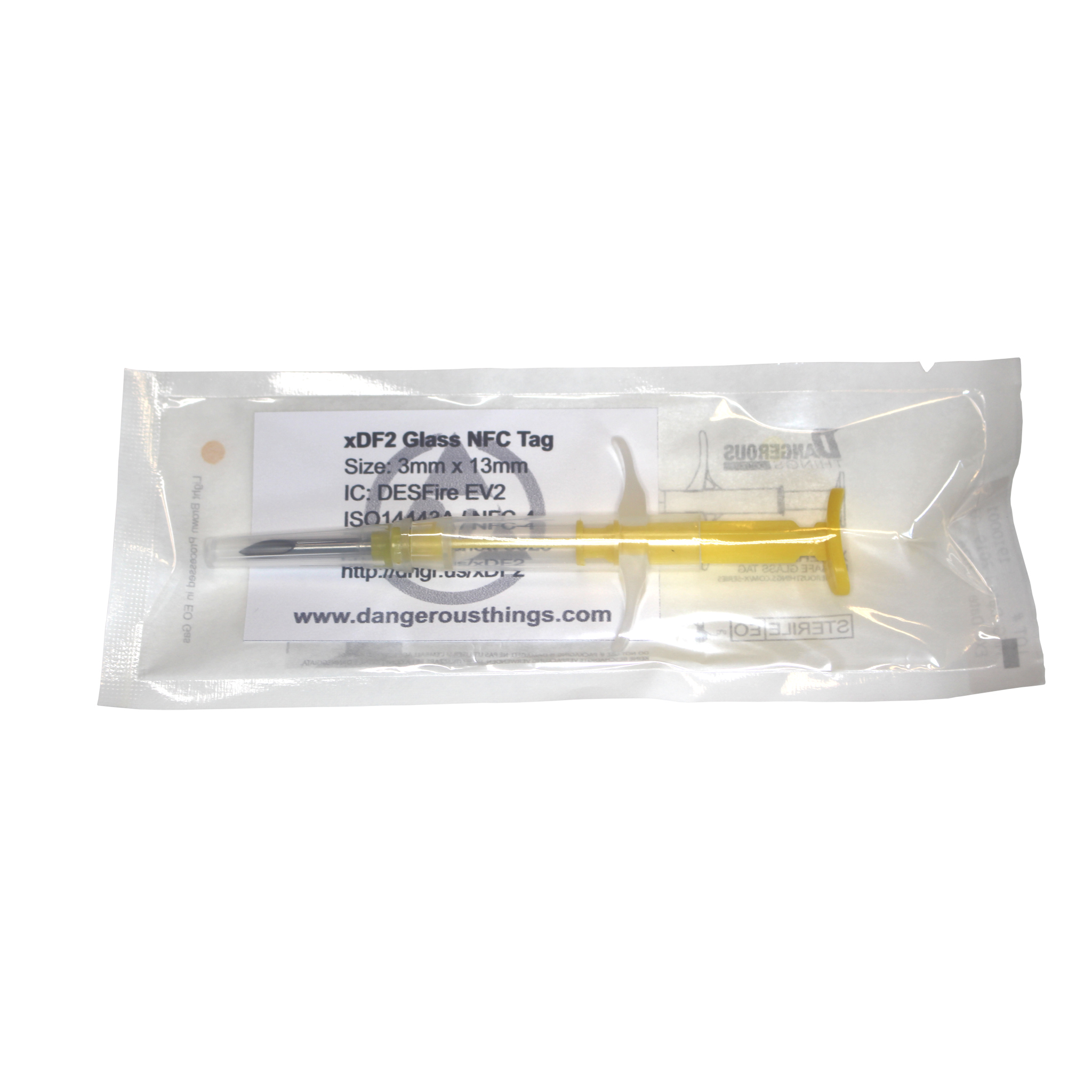

  • Pre-tested and pre-loaded into sterile injection assembly
