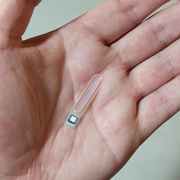

  • Implantable 8mm x 38mm x 0.4mm secure element smart card platform
  • JCOP 3 OS supporting Java Card 3.0.4 applets on 144 KB EEPROM

After 3 grueling years in development, we are proud to bring you the VivoKey Flex One! The Flex One is a patent pending subdermal secure element enabling fully autonomous separation of your cryptographic keys and functions from vulnerable general computing platforms such as your smartphone or computer. The ability to not only carry your OTP, PGP, and other cryptographic keys with you at all times, but also perform cryptographic functions in vivo (generate OTP codes, encrypt & decrypt data, etc.) without ever revealing private keys to the NFC interface you are interacting with is a huge step forward for personal digital identity and data security.
