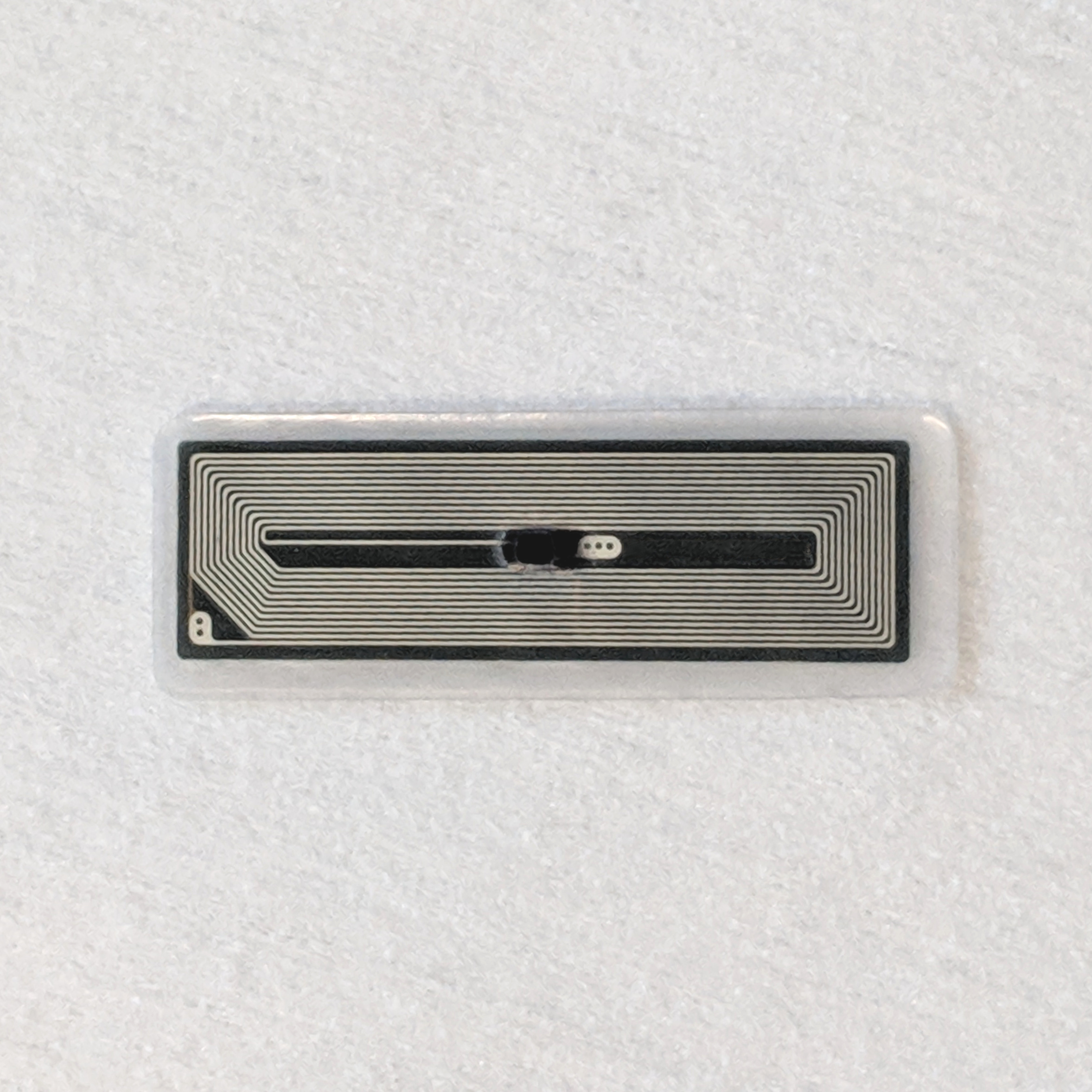

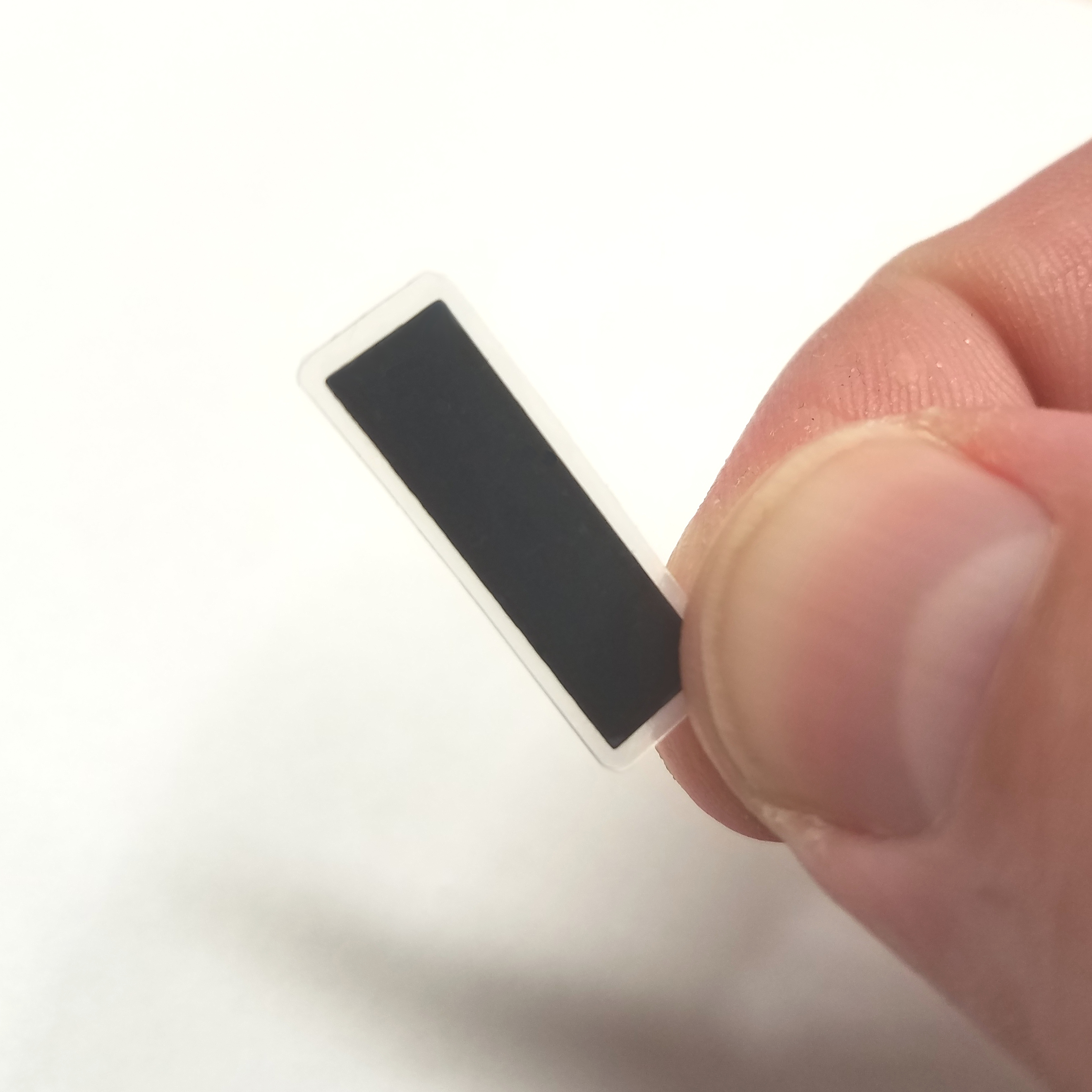

flexNT NFC Chip
  • 13.56MHz ISO14443A & NFC Type 2 chip
  • 8mm x 22mm x 0.4mm flexible biopolymer package

The flexNT is one of our next generation, high performance, RFID and NFC compliant transponders. It is coated in USP Class VI, ISO 10993 tested biopolymer which gives it an extremely thin profile and flexible structure suitable for installation just about anywhere. The flexNT has the same chip as the xNT, however the flexNT offers many times the readability, range, and performance of the xNT. They are shipped in small sealed plastic tubes with chlorhexidine solution.
