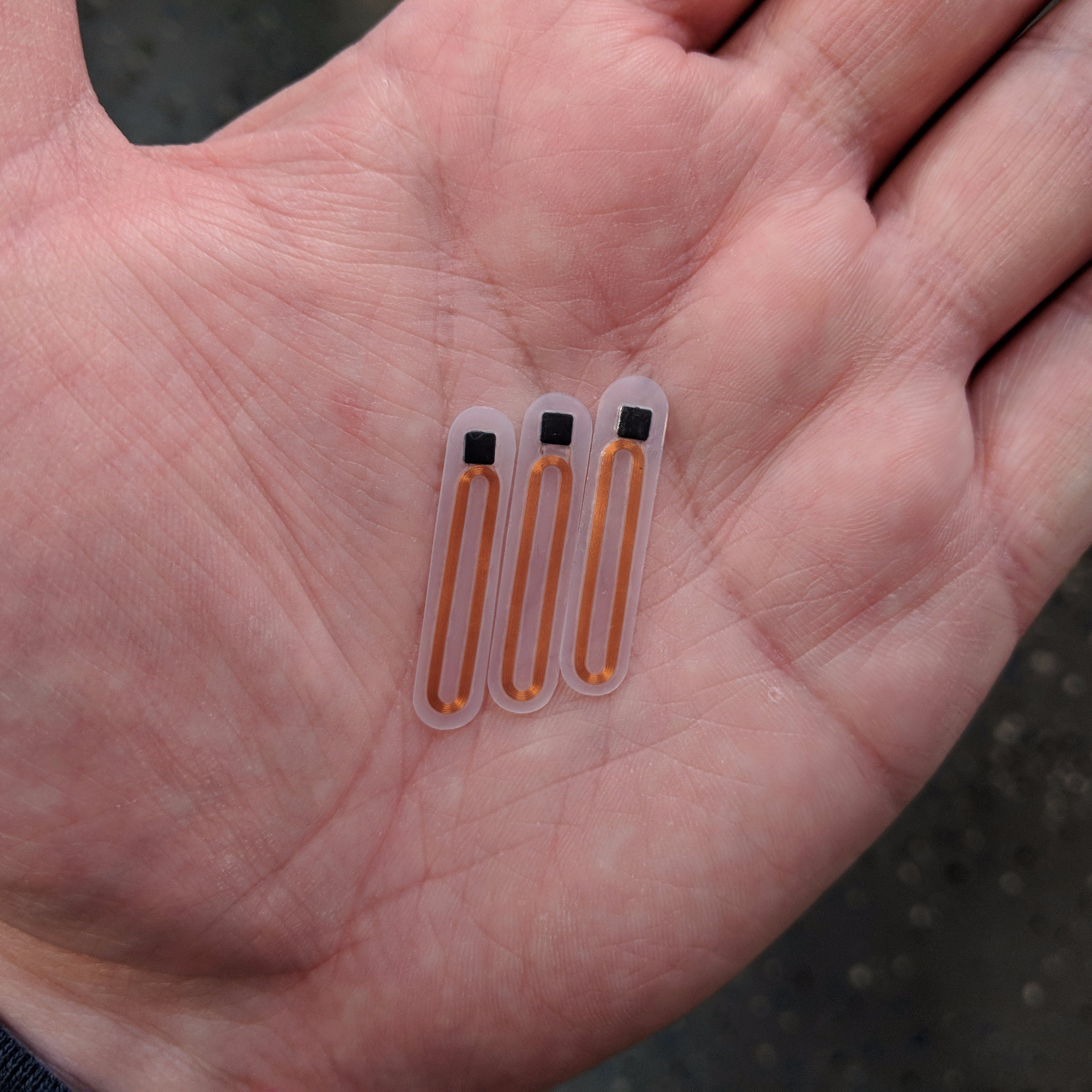

flexDF NFC Chip
  • 13.56MHz ISO14443A & NFC Type 4 DESFire EV1 chip
  • 7mm x 32mm x 0.5mm flexible biopolymer package

The flexDF is one of our next generation, high performance, RFID and NFC compliant transponders. The flexDF is coated in USP Class VI, ISO 10993 tested biopolymer which gives it an extremely thin profile and semi-flexible structure suitable for installation just about anywhere. The DESFire EV1 8kB NFC Type 4 multi-application chip inside the flexDF allows large, cryptographically secured data storage. They are shipped in small sealed plastic tubes with chlorhexidine solution.
